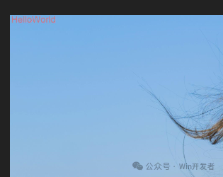

实现逻辑如下:
public static void DrawWatermark(string imageFilePath,string watermark)        {            using (MemoryStream ms = new MemoryStream(System.IO.File.ReadAllBytes(imageFilePath)))            {                Bitmap bitmap = (Bitmap)Image.FromStream(ms);
                using (Graphics graphics = Graphics.FromImage(bitmap))                {                    var size = (float)(bitmap.Height * 0.02);                    if (size < 10)                        size = 10f;                    using (Font arialFont = new Font("Arial", size, GraphicsUnit.Pixel))                    {                        var location = new Point(00);                        graphics.DrawString(watermark, arialFont, new SolidBrush(Color.FromArgb(120, Color.Silver)), location);                    }                }
                bitmap.Save(imageFilePath);            }        }
绘制出来大概效果如下:
